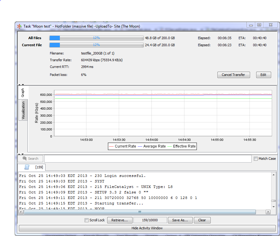

We couldn’t resist testing this scenario with our FileCatalyst accelerated file transfer protocol. In our lab using a WAN network emulator from Apposite Technologies, FileCatalyst HotFolder, and FileCatalyst Direct Server, we used the following parameters:
- Bandwidth: 622Mbps
- Delay: 3000ms +/- 150 ms (for jitter)
- Packet loss: 5% (NASA mentions negligible network loss)
The Result
About 602Mbps. That’s 95% link utilization, the other 5% is the pocket loss! See the screen capture below:
